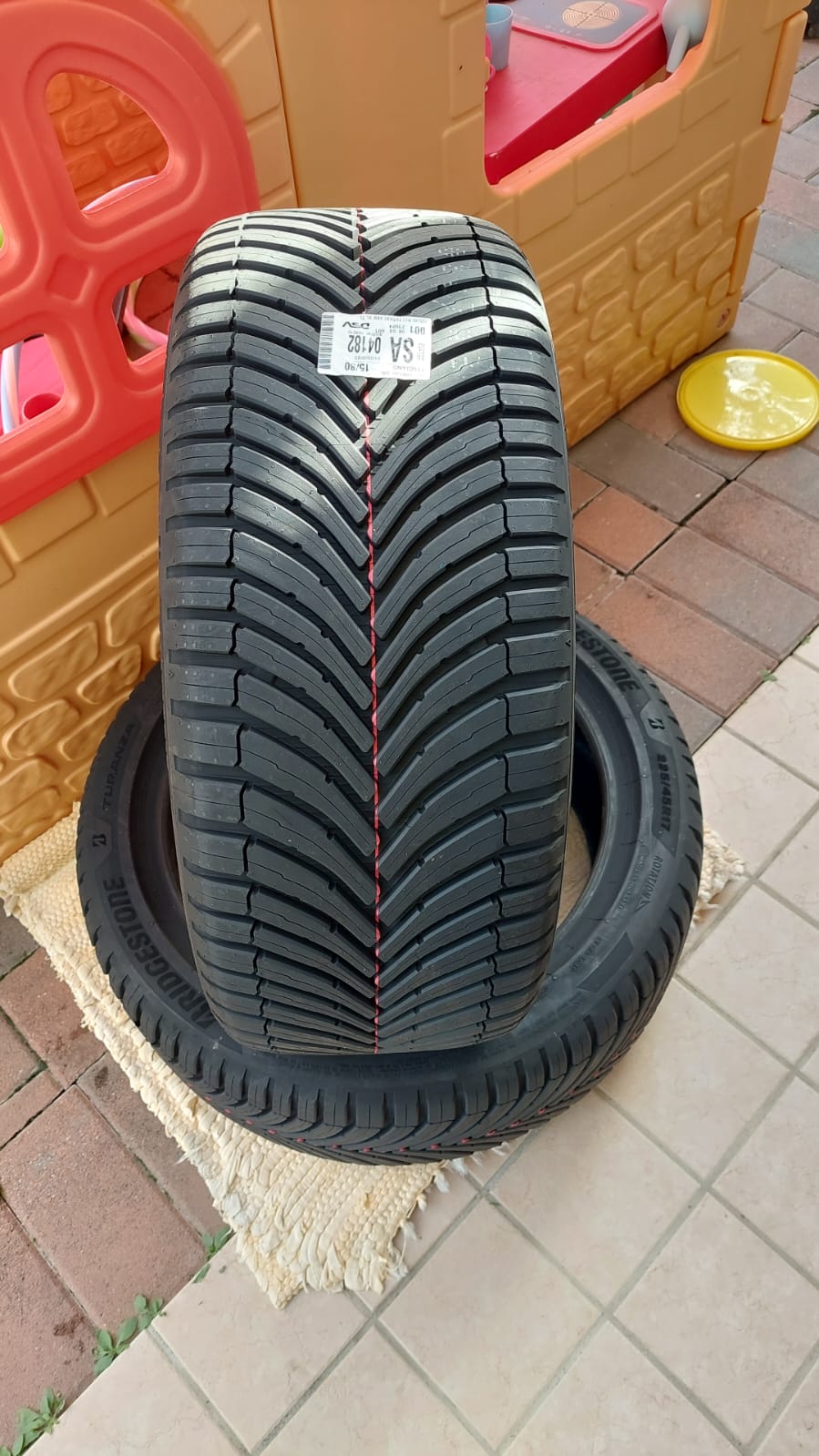

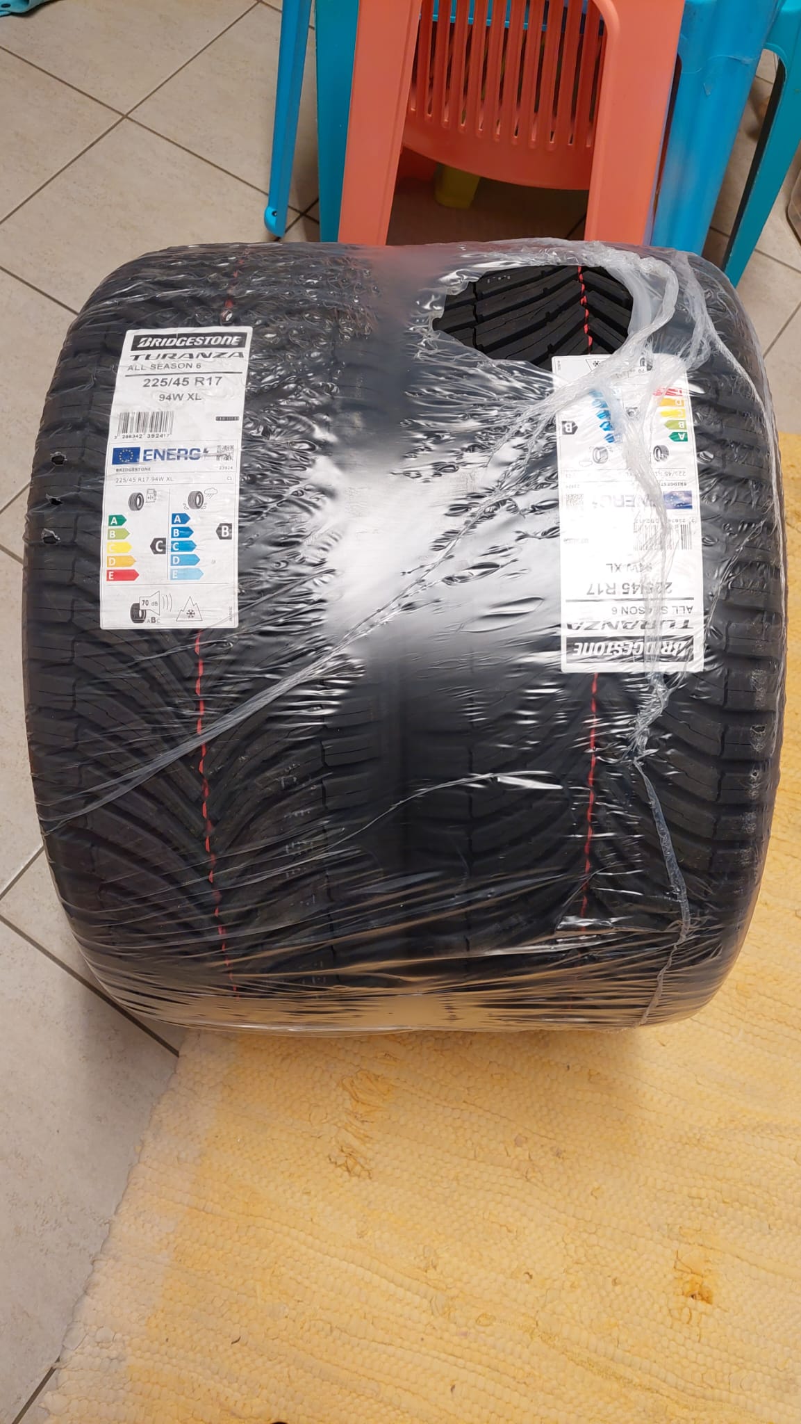

Prese! (per la 500l)
WhatsApp Image 2023-11-14 at 12.53.59.jpeg WhatsApp Image 2023-11-14 at 12.52.57.jpeg
Quanto le hai pagate?
