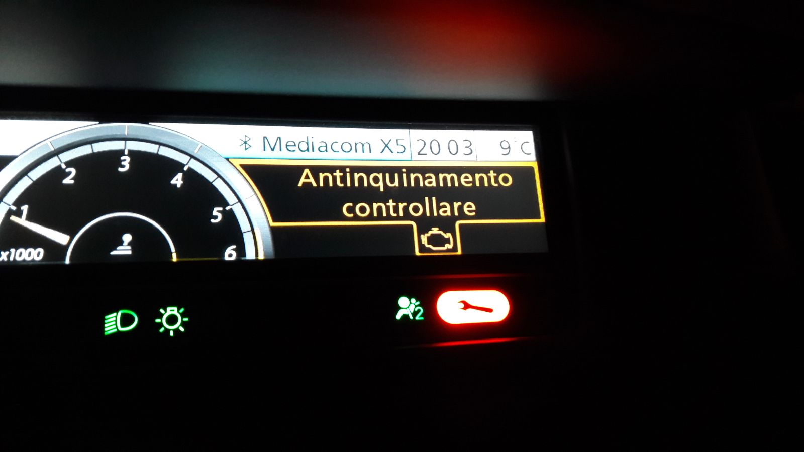

Sorry guys iam writing in English, iam osaze 2 base in Milan my Renault scenics 2009 seven seated,from on the 1of January 2018 their is the spia with ANTINQUINAMENTO CONTROLLARE, WITH INIEZIONE CONTROLLARE. I have spent 1000 euro since 1 of January, I have been to Renault office in Grandolfo Auto srl in Milan pantigliate where I paid almost 700 without without them preparing my car,was told by them that they need to call expert from Renault ,and they are Renault too.so I collected my car with the same problems that make me took it to them.those anybody's have an ideas about it please.
In fact they change intercooler that according to them was the problem,even the car take time to start very hard to start.
But it has never shows any code on the dashboard or where can I fine it,I have all the payments list from Renault I check.

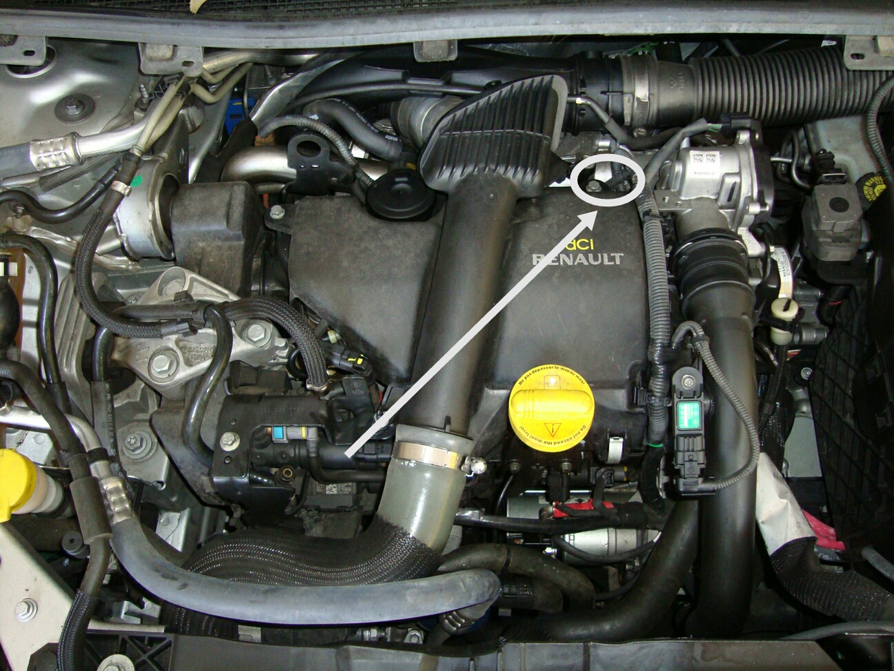

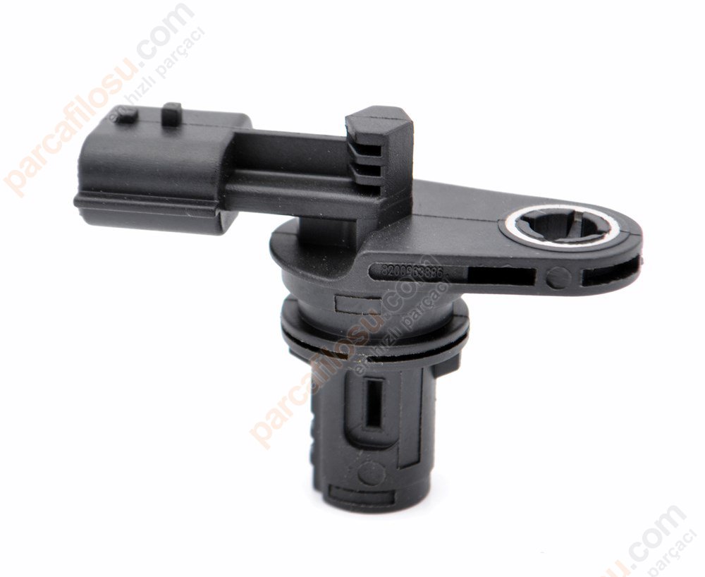

Morning just call Renault this morning they give me this number as the code of error 034038,...pls kindly help me out what it mean with this.
ok. P0340 is the error code of the camshaft position sensor. in the simplest cases it is enough to replace it with a new one which costs around 40 euros. if the problem remains you must deepen and check the electrical wiring.
